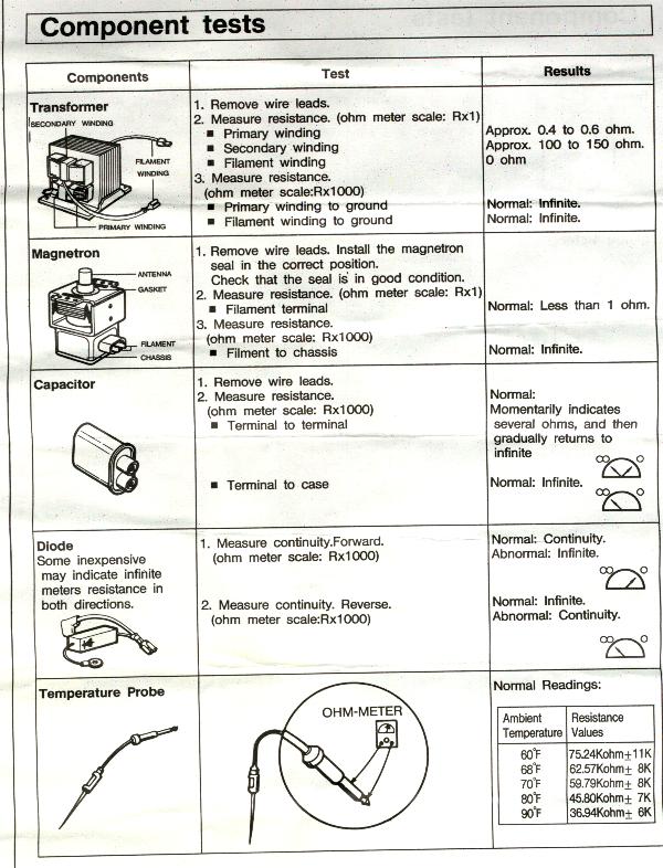

I am replacing a magnetron in a Whirlpool gm8155XJB-0 microwave. The schematic does not differentiate between the F and FA terminal connections. It only shows the filament connections without labels. The...
Poring over a few schematics, I see them connected both ways.
One one hand, microwave technology guru J. Carlton Gallawa says that it matters to achieve proper phasing (http://www.microtechfactoryservice.com/Ch7Pg6.html), but he does not explain what the abbreviations mean or what the standard is for connecting them!
I'm an electronics engineering technician and microwave servicer with over 30 years of experience, and it seems pretty obvious to me that "F" would stand for "filament" and "FA" stands for "filament, anode."
So I would connect to the "F" terminal the transformer filament lead which has nothing else attached to it.
I would attach to the "FA" terminal the other filament lead, which is also attached to the downstream side of the high voltage capacitor and to the "anode" of the high voltage rectifier diode.

I have a Natioanl NN-6207 Microwave,I have replaced the magnetron and the fuse, every time I switch the microwave on it makes a loud humming noise and blows the fuse. The magnetron has two terminals F and...
F and Fa could be the problem but.... You must check the power diode and the high voltage capacitor. One of these is most likely the reason the fuse failed in the first place. Ground the HV capacitor by holding an insulated screwdriver well back on the handle. The locate the Power Diode that will have at least ONE terminal that connects to the capacitor. Power doides are either 3'8 inch wide and 2 inches long or round an liik like a bit resistor with no color markings. ' Check the HV capacitor by rading each terminal to the case of the capacitor (no shorts allowed)
Then read across the capacitor terminals with the meter set on R x 10K. Watch for an initital jump in resistance and then it drifts up to infinity. Reverse test lead positions and you must get the same result. Resistance and then drift to infinity. Any other reading.... infinity in both directions, short to the case or short across the 2 terminals = bad Cap.
If after you perform the above tests and you still have the problem ... knowing you might pop another fuse there are 3 door switches. 2 of them will read resistance / continuity across the terminals when the door is close and one of them will read continuity across the terminals when the door is open. One of the 3 switches has 3 wires on it... the 3rd wire shorts the magnetron power when the door is open and the power relay / HV circuit is powered. This is a built in blow the fuse to prevent magnetron operation with the door open.
I think your are going to find that either the power diode or the HV Capacitor has failed.

Hi, my microwave is not heating and i cannot hear any humming sounds either. I replace a new magnetron already and it's the same. What else could it be? do you think I should replace the capacitor, diode...
I would have started with the diode and capacitor (i.e the least expense) but you can check the diode by removing the input wire and doing a continuity check in BOTH directions. In other words check it then reverse the leads and check it again. It should only read in ONE direction. If it reads continuity in both directions or is open in both directions it is bad and must be replaced. If the diode check out fine then by all means check the capacitor. Just respect the fact it is a large capacitor and can really ruin your day if it is good and has a full charge. (Been there done that!) Take a screwdriver and ground across the terminals several times then note the position of the wires on the capacitor and remove the wires from ONE terminal set. Take your meter still on Ohms ( old simpson type dial meter for this test) and place it on the capacitors 2 terminals. Then rapidly reverse the leads and you should see a momentary jump on the meter then fall off. No jump when you repeatedly reverse the leads then the capacitor is bad. This should solve your problem unless there is a relay on the control board that controls the magnetron power.

Panasonic 1250 Watt genius microwave- will not cook. message refer to operators manual before use. Have owned for several years, has run afew times after unplugging for a few minutes, then nothing. clock,...
 Confirm 110-120 volts AC is entering the primary coil on the high voltage transformer....meter works but can be fooled, I usually rig up a light socket and household light bulb and hook that to the 2 input wires for the transformer and see if the light works or not when you run the microwave....can even set a power level and watch the light go on and off. Discharge the capacitor first before attempting any checks or tests.
Scary but works!....
If ok, put those 2 wires back on the transformer. Discharge the capacitor .
Remove the 2 wires going to the magnetron....run the microwave a few seconds ( 2-3 ) and remove power....again discharge the high voltage capacitor . If you got a good crack&spark when you discharge the cap the second time you are creating high voltage but not using it ( bad magnetron or loose High Voltage wire somewhere )....if you get no crack&spark you are not creating high voltage.
How to check a common high voltage diode - click here. Check the diode with one end off/disconnected....should show continuity one way, reverse your meter leads and none the other way.....many meters are not high/good enough and often show no continuity ( infinity ) in both directions. A full continuity reading in both directions  (0 ohms) on the diode may be shorted/bad one!
Many  microwaves however have a defect in the microwave distribution system which causes the magnetron tube to overheat and cut out and/or damage the diode.
Whirlpool mh7140xfq
Here are some links you can use for test help, but read the safety warnings first:
http://www.gallawa.com/microtech/cap_test.html (if it is NOT shorted, it's probably fine)
http://www.gallawa.com/microtech/diode.html (if it is NOT shorted, it's probably fine)
http://www.gallawa.com/microtech/mag_test.html
http://www.gallawa.com/microtech/xformer.html
The average DMM doesn't have a high enough voltage to bias a high voltage diode, which is several diodes is series.
If the diode was not shorted, it was probably okay. They almost always short when they go bad.
I don't advise people on measuring a microwave's high voltage. The voltages can be instantly lethal.
The tech sheet should show you how to measure the resistance of the windings of the high voltage transformer. You know you're getting 120V on the primary.
The capacitor is probably okay because they usually short when they fail, and that would blow the fuse when you hit Start.
Look for corrosion or signs of melting on the FA terminal of the magnetron (and on the other temrinal if someone reversed the wires). Look fro a loose connection at the magnetron.
If these connections are fine, then you probably have a bad magnetron.
