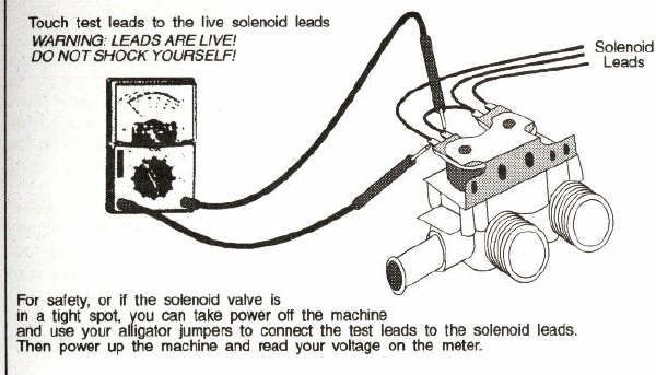

Filling noise When filling, loud 'water hammer' type noise. Was momentary but now continuous unless I switch from cold to hot and back. Thanks for any help. Jack

Jack, I was on a service call the other day with the same complaint. I have a pressure gauge rigged up to test the water pressure at homes. I removed the washer hose at the shut off valve and put the gauge on. Ideally the pressure should be at around 55psi, 75 max. In this case it was about 100psi. The hammering started with the gauge still attached, no lines to the washer. The customers regulator was bad. Im not saying this is your case, but it's possible. Catriver...post back.
Kitchenaid top loading washer makes noise when filling
Did you check the hot and cold shut off valves if they have calcium build up it might make a noise. Try replacing them.
Water hammer makes a loud vibrating noise when filling
Hey- most hammer is removed by simply replacing the water valve. Have solved this way many times. Exceptions required spring suppressors on lines to faucets. Valves run about 40-60$ and are easy to install. Let me know if this info helps- have more if needed- Thanks- Ed

The water fill valve - The water fill valve is a mechanical and electrical part, the coils on the valve need electricity to mechanically open the valve to allow the water to flow into the washer....myth....the washer pumps water into itself...no, it does not. The fill valve opens and the house water pressure pushes the water into the washing machine.
No cold water or no hot water - The fill valve has two coils, one for the hot water and one for the cold water. It is possible that one of the coils can fail and you loose that filling ability. If the cold water coil quits, the hot will still work and during warm fill you will get hot water only and during a cold fill you will get no water at all. If the hot coils quits, you will still have cold water fill, cold water only on a warm setting and no water on a hot fill setting. You can No cold water or no hot water - The fill valve has two coils, one for the hot water and one for the cold water. It is possible that one of the coils can fail and you loose that filling ability. If the cold water coil quits, the hot will still work and during warm fill you will get hot water only and during a cold fill you will get no water at all. If the hot coils quits, you will still have cold water fill, cold water only on a warm setting and no water on a hot fill setting. You can test a fill valve live for 120 volts, power to a fill valve coil and no fill = a bad fill valve. You can also test the coils for continuity, no continuity = a bad fill valve. Some Maytag washers have a fuse in the fill valve circuit, if this fuse let go the washer will not fill. Fill valves can also from time to time stick open and not stop filling. If you have to shut off the fill valves to stop the water from filling in the washer, you have a bad fill valve and you will have to replace it.
