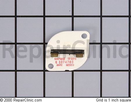

- I have put the timer know back on and will check the thermal fuse. diagram shows that the dryer has two inline thermal fuses. They are both actually on the same run. The only way to access the inside of the dryer is to pull the front panel. I have done that and can now see below the drum. What will the thermal fuse look like? It is not located on the vent. It shows that it is close to the drive motor. I am assuming that is where the small belts are running off of a pulley. A little more advise and I should be able to test it. Thanks again for your help.
Nov 10, 2009
- I jumped both of the thermal fuse's and it still wouldn't work. So, unless there is something else to check then it must be the timer. Thanks for your help.

- There is one way that you can confirm. You can bypass the thermal fuse (just connect the 2 wires together) for testing purposes only. The fuse is usually located on the vent duct, inside the dryer. If the unit runs in this state, the fuse is the culprit. If it continues to not run, while the thermal is jumped, this will confirm timer failure.
This is a safer way to confirm.

- The thermal could be mounted on the lower housing, as well. Most common location is on the vent duct.

- Ok, the thermal fuse is located, and mounted on the Heater chamber. The second device you speak of will be the Hi-Limit cut- off thermostat. Click on the below link to access an exploded diagram of the heater assembly. The First thermal fuse will be labeled #4. The heater chamber will be labeled #3. The cycling thermostat will be labeled #8. The second thermal fuse(Hi limit thermostat), will be labeled #11.
Jump both thermal fuses, one at a time.
