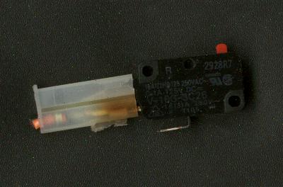

It sounds like I have the same problem. Microwave runs but does not heat. What is invloved with replacing the door siwtch and/or the board sensor? Is this something that needs a technician? My microwave is 1 1/2 years old.

Not sure what you mean by a board sensor, but you can do a Yahoo search for my text file "doorsw.txt" which will give you important safety tips and help you find, diagnose and replace the door switches. You can find exploded view diagrams of this oven at http://www.geappliances.com/shop/prts/ On that page, select "repair part" under step one. Under step two, selct "Microwave" from the drop-down menu. Then when you click "GO" a pop-window will come up for you to enter your model number and it will lead to the parts lists and diagrams. But as detailed in my file "doorsw.txt" you can find generic switches locally at applaince parts stores in your area.

Why does my ge spacemaker jvm1740dd1cc no longer heats and the turntable does not work?
Bad door switch. Look for burnt terminals on one of the door switches. Replace the switch and cut off the burnt terminals and splice on new ones.

GE Spacemaker 1400 acts like everything works but does not heat.
Hello :
This happens because of a bad door switch . The plastic mounts inside the microwave which hold the door switches and onto which the door latches lock when you close the door .

I have ge spacemaker microwave heats but fans dont come on .
This most commonly is a bad door switch, other possible problems are a faulty relay or solder joint on the power module, but a bad door switch is most common.
