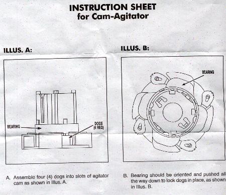

Washer problem I am trying to fix my washer. I have a Whirlpool LSQ9544K. The top part of the agitator doesn't agitate. I need to know how to get the top part of the agoitator loose so I can replace the "dogs". I have them. Is there a special tool to do this with? I have the agitator off the machine. I just can't get the top agitator off.

you have worn dogs and they need to be replaced,remove the top of the agitator where you put the fabric softener,just pull it up,then pull up the cover and remove the 7/16 inch screw and sepatate the agitator,you can pull the whole agitator out of the washer and work on it and then replace the dogs,go here and you can see the parts and price http://www.searspartsdirect.com/partsdirect/part-model/Whirlpool-Parts/Washer-Parts/Model-LSQ9549LW3/1198/0153200/W0312163/00003?blt=06&prst=&shdMod= and watch this video on how to change them out,hope this helps and GO PATRIOTSyou want the agitator cam kit part number 285809 and it's around 15 dollars. http://www.youtube.com/watch?v=0GQh8JLqVv8

this is for the whirlpool washer,if you grab the top of the agitator can you spin it both ways without it grabbing,it should only spin one way,if you can spin it both ways you have bad dogs,the agitator cam kit part number is 285809 and it's around 13 dollars.pop off the center cap of the agitator,remove the 7 1/6 inch screw in the middle and pull off the top of the agitator to get at the dogs,you'll see them there are 4 of them,they waer down and the top of the agitator doesn't work.watch this video.

Sounds like you might have bad agitator dogs. Remove the agitator cap, theres a 5/16th bolt that needs to be removed then the top of agitator comes off. The dogs are 4 little gears with teeth on them, when they get worn the top half of the agitator doesn't move.

  • Pull the liquid softener dispenser off the top of the agitator. Pull the clear plastic cap out of the center of the agitator. Use a ratchet and socket set to remove the hex head bolt from the center of the agitator. Lift the top half of the agitator out of the washer. Pull the bottom half of the agitator straight up to remove it from the drive motor shaft, and remove the bottom half of the agitator from the Cabrio washer.

    Washer has trouble agitating... Check the agitator dogs inside the top of the agitator, they are bad for wearing out, sometimes the agitator may only agitate one way when the dogs are worn out. This is an instruction sheet that came with the last parts I ordered for a Whirlpool/Inglis style direct drive washer agitator. If you need to replace your agitator dogs, please see this link for some repair aid.

    You need to replace the agitator dogs inside the clothes mover (agitator). take of the top then the cover, remove th bolt and take the top half off. you should see four "dogs" that need to be replaced.
